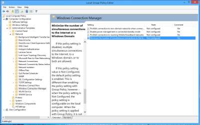

This certainly works for me but in my case it's two different IP's and both are active connections, wired/wireless are both connected to the internet, of course Windows is only using one of those connections at a time but I'm able to ping both of them without problems.
I use a group policy that allow Windows to connect to both at start up.

My firewall doesn't block any ping requests on either of my network interfaces despite having them both working with different IP's at the same time. No need to change the metric in my case, the entire metric thing is overrated and inconsistent at best.
I can only guess that the Op may be trying to ping those IP's outside of the gateway's subnet which won't work without some type of routing set up.
In case you were wondering about the GPO setting, Windows will not consistently connect to both interfaces at start up like it does now, unless that setting is disabled. I just use the wireless for testing.
Both of my connected interfaces with different IP's showed no delay or dropped packets with the ping, that was the only point I was trying to make. :geek:
