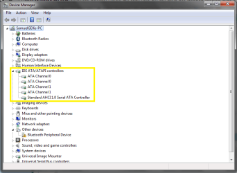

Should I uninstall any of these?
No. Those are the controllers that control your hard drive and dvd drive. Try burning a blu-ray disc and see how the drive runs. If it burns the blu-ray disc sucessfully, then it may just not read cds and dvds anymore for some weired reason. I would suggest you get it replaced under warranty.

I think you can leave those alone for now.
