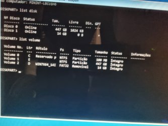

Hello Thank you for your interaction and help ,
For a better understanding of my problem.. see this SS, and now what should I do?
note :
*I only booted with 1 pendrive and the SSD
*Volume 0 and Volume 1 is the SSD with boot problem
*Volume 2 is the pendrive
*Something strange is that the SSD has the letter "E" and another part of the SSD has the letter "C" originally this SSD belongs to the letter "C" so I don't understand why it is divided, maybe this is the source of the problem.
*I tried to select volume 1 and then use the command "assign letter=C" to assign the letter "C" to volume 1 and it didn't accept it.
I haven't tested your suggestion yet because I wanted to show you this image first...to see if I really should proceed with your previous suggestion or a new one...
thank you very much
It is normal for drive letter assignments to look different from booted media.
to exit diskpart type:
exit
(then press enter)
then at command prompt type:
bcdboot e:\windows

If the system partition was not already active it needs to be marked active on an mbr style disk.
in you screenshot the 100mb system partition has letter c
the large windows partition has letter e
therefore
bcdboot e:\windows /s c:

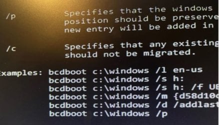

You need to boot from the pendrive in bios mode (not efi) if you want to use win7 bcdboot.exe for an mbr system.
Newer versions of bcdboot have the /f switch which can be used when booted in the the wrong mode.
