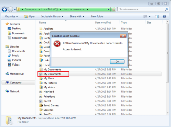

This works for me on both operating systems:
copy "%userprofile%\my documents\folder1\file.ini" "%userprofile%\my documents\folder2\file.ini"
pause
That is why these hidden links exist...
...so that programs (and batch files) can make use of them.

Thanks UsernameIssues for the suggestion but when I tried it I got error message please refer to the picture.

I was hoping that you had moved the entire profile to the D drive per this procedure:
http://www.sevenforums.com/tutorials/87555-user-profile-change-default-location.html
That makes the %userprofile% variable point to the correct folder... it should work on XP as well.
