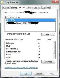

Sounds like you have an issue with the user/temp folder security permissions.
If you go to the USER temp folder and right click on the folder then look @ the security section and see if there is a listing for SYSTEM like the pic I have uploaded, if not, you will need to add it by clicking the edit button on the right and then ADD SYSTEM as a security user then, give it full permissions.
It is a common fault with windows, it's worth a try.
