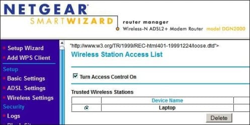

Hi Kharl, is this setting on your Netgear in use ????
Hi Roderunner, thank you a lot for your answer!
No, that setting is not in use.
