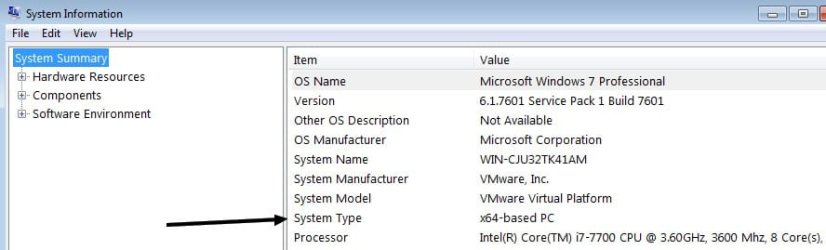

Chose Windows 7 32 bit or 64 bit depending on what you have there. To find out type system information in Windows search. Now find where it says "system type."

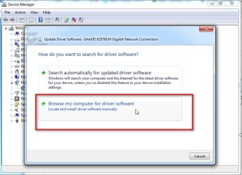

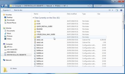

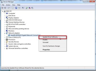

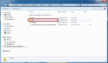

when you have located the 64 folder, open device manager, rt clcik the network adpater, select update driver , select browse., then browse to the Network Realtek ( or it might say RTL8111 ) 64 folder you found on the cd

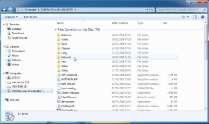

Hello SIW2. I followed your screen shots and I opened up the files on my gigabyte motherboard cd and it doesn't display anywhere a network folder. Thanks.

When you insert a DVD it can autorun a program. In your case it is trying to run Setup. Cancel.
SIW2 has given you a description on how to load the LAN driver.
- Open Device manager (C:\Windows\System32\devmgmt.msc) and search for the driver on the DVD.
