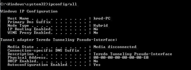

I would have to see a screen shot of the ipconfig/all to see how the network adaptors are configured. :)

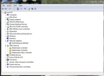

So this is the ipconfig i am seeing, as well as the device manager errors. When i try to connect using the broadband PPPoE connection i get errors 561 or 797. I am unsure of what to do next, i have tried the default solution of replacing rapppoe.sys in windows\system 32\drivers with a copy from my working pc and that hasnt helped. I also downloaded the LAN drivers and Modem drivers from the Acer webste and windows cant find the drivers in those folders. Any ideas would help, thanks

From the Device Manager you don't have any network adaptors installed at all here. It's no wonder the ipconfig/all isn't picking up anything. I'd like to help but I don't have anything to work with here. :confused:
