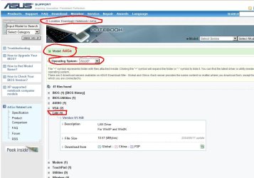

First thing I did was go to this page
ASUSTeK Computer Inc.-Support-
and then choose the appropriate options
and then i got this
i chose to view drivers for xp, since i wanted to find out which lan chipset is used with your adapter, and because you said the adapter worked in xp.

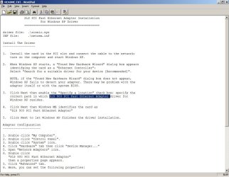

I then downloaded the xp driver, and unpacked it, and looked inside the unpacked driver package, especially in the WinXp driver folder to see whether i could find any info on the chipset.
This is what i found :
So assuming that im on the right track so far, and the chipset in question is SiS900,

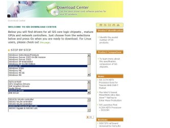

I searched the internet for SiS website, to see whether they have a newer driver that you would be able to download and install in Windows 7.
http://www.sis.com/download/
But here is the problem, as you can see in the 2 screenshots above, when i choose to download a SiS network driver for xp, there is an option to download a driver for the SiS900 chipset, but when i choose Vista as an OS that i want to download drivers for (there are no Win 7 drivers, Vista is the latest OS they have drivers for), there is no option for that chipset, only for SiS163U WLAN and SiS190LAN and SiS191 Gigabit LAN.
