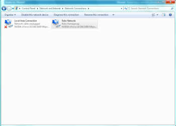

Are you saying they don't show up like in the picture below? I never needed to adjust any settings there in order to get Homegroups working.

That's right. Mine doesn't show anything but a Bluetooth connection there.
