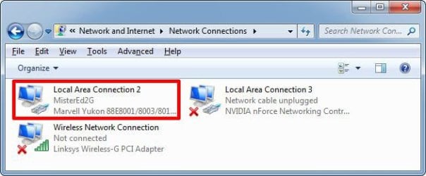

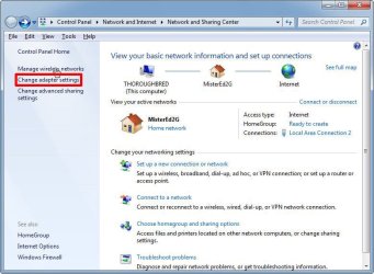

I don't know if I understand what you want to tell me. If there is anything that might help, please provide a screenshot
Does your computer have a wired, wireless, or both network adapter? You said you were connected to the Internet. How are you connecting? In Network and Sharing Center click on Change adapter settings. You will see how you are connected.
Below you will see I have 2 wired network adapters and 1 wireless adapter. I can connect with any of them. You see I am connected to one of the wired adapters. The other two have an X next to them.

I don't know about the OP but I don't know what you are talking about. What do you mean by secondary connection? All the network connections I show are valid. My ASUS A7N8X-E Deluxe motherboard has{
Two Ethernet ports:
1. Integrated chipset Ethernet controller 10/100 Mbps
2. Marvel Yukon Ethernet controller 1000 Mbps
It also has a PCI card for WiFi:
Linksys WMP54GV4 wireless 802.11 b/g
