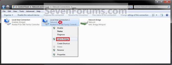

5. To Add a Connection to the Network Bridge
A) Right click on the Network that you want to add, and click/tap on Add to Bridge. (see screenshot below)
B) If prompted by UAC, then click/tap on Yes (if administrator) or type in the administrator's password (if standard user).
C) After a moment, the network will be added to the bridge. Go to step 7 below.

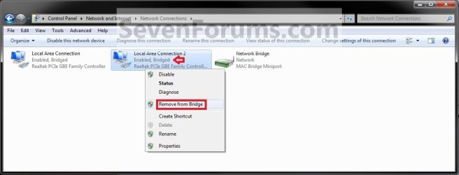

6. To Remove a Connection from the Network Bridge
A) Right click on the Bridged Network that you want to remove, and click/tap on Remove from Bridge. (see screenshot below)
C) After a moment, the network will be removed from the bridge. Go to step 7 below.
