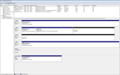

If you'll post back a screenshot of Disk Management - Post a Screen Capture Image we can look over the config to see if it anything is obvious.

Drives all look fine from a disk management perspective. All the eventvwr logs are clean. The interesting thing I noticed is that there were no entries for an unexpected reboot, so the failed boots never got to that point. I forced at least a half dozen hard reboots, but none popped on the logs. I'll try the startup repairs from disk again to see if that yields any results. I let the first attempt go 2 hours before I started digging in, and the other attempt about 30 minutes. Do you recommend a certain amount of time to let them run without finding any issues?

I asked to see Disk Management, not whether you thought it was okay. We tend to see things others don't after reading tens of thousands of them.

We needed to see Disk Mgmt with all volumes plugged in as it says in tutorial. Often this is enough to see the problem, another reason why this is the top tech site on the web. We have the top experts in every field here to learn from.

That said, I'm gonna bite since I don't believe you have any idea on this one (and the fact you seriously come off as some form of angry cartoon character.) Here's the disk management screen. If you can pull root cause out of this, I will buy you a cookie and bow to your superior intellect.
