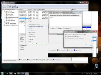

i think u can use partition manager from the device manager to change the drive letter
here is some screens to help
but i dont recomend this method it does it only on the installed os not (temp) and will effect to have a missing drive in the order
but here is it anyway

err.. you can change drive letters.... right click your Computer icon on the desktop or start menu and go to manage.
Under storage click disk management, you can than rename drives.....
You cannot change the partition letter on a system drive. MS tutorial for doing this is only if the drive letters change mysteriously. You will definitely boink your install.
There is no mystery here. Win7 arranges drive letters so that it is always the C: drive when you are in it. This has no effect whatsoever on your file storage or referencing of other drives.
Test drive it for awhile and see. You are all set to bail out of XP and Vista with your future OS lettered C: This should occur around.......tomorrow.

Win7 does take the drive letter C, when you boot into Vista it will have the drive letter C, Not sure with XP as I haven't dual booted it with Win7.
This allows all your programs to run with the C drive, everyone (programs) is happy.
the operating system you run generaly assigns drive letters, so where the o.s. is installed will be C. if you boot into xp, xp will assign that partition to C and give 7 something else. and vice versa.
