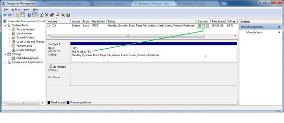

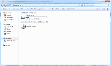

Hi everyone,
My laptop has a 465 GB hard drive which I divided to 2 partitions (drives C and D having 318 and 147 GB respectively) using the 'Shrink Volume' option in Disk Management. I have been using this laptop for only a few days and noticed this morning that my second partition (drive D) is no longer showing up in windows explorer. Drive C shows with a capacity of 318 GB in explorer but I could not locate the second partition even in Disk Management. I was already using and accessing files from Drive D before it disappeared. I'm wondering if windows update had anything to do with it as it was the only changes I made to the system the last time I shut down.
I have attached screenshot of Disk Management and Windows Explorer. Notice the disparity in disk size indicated for Drive C within Disk Management. Any help would be appreciated.
Thanks.

ibarra,
Welcome to SevenForums.
Let's see what Win 7 thinks. Following will put a file called computerinfo.txt on your desktop. Attach that file to your next post please:

Hi KarlSnooks,
I ran Powershell and the script you provided. Here's the output related to Disk Volume information:
DISK Model : HITACHI HTS727550A9E364 ATA Device
DISK Size : 466 GB
DISK Status : OK
DISK Capabilities : {Random Access, Supports Writing, SMART Notification}
DISK Interface Type : IDE
DISK Partitions : 1
DISK Bytespersector : 512
DISK Sectors per track : 63
DISK Firmware revision : JF3ZD0H0
DISK Device ID : \\.\PHYSICALDRIVE0
DISK PNP Device ID : IDE\DISKHITACHI_HTS727550A9E364_________________JF3ZD0H0\5&1BBE8
366&0&0.0.0
################## DISK VOLUME 1 ################### : ****************************************************************
DISK VOLUME 1 Caption : C:\
DISK VOLUME 1 Drive Letter : C:
DISK VOLUME 1 Label :
DISK VOLUME 1 Capacity : 319 GB
DISK VOLUME 1 Free Space : 284 GB
DISK VOLUME 1 Volume Type : Partition
DISK VOLUME 1 Boot Volume : True
DISK VOLUME 1 System Volume : True
DISK VOLUME 1 Compressed : False
DISK VOLUME 1 Serial Number : 2252459421
DISK VOLUME 1 File System : NTFS
DISK VOLUME 1 Block Size : 4096
DISK VOLUME 1 Indexing Enabled : True
DISK VOLUME 1 Auto Mount : True
DISK VOLUME 1 Dirty Bit Set : False
It seems windows 7 still cannot detect the previously accessible partition
in Drive D. I have included the contents of the entire file in the attachment.
Thanks.
