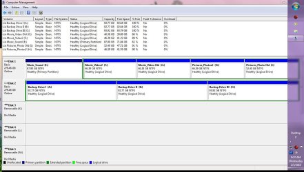

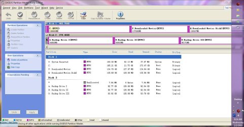

OK...downloaded iso...before I start tho I want to post one more item...Windows Disk Manager does not now show the C:\ drive...(main Win 7 installation)...only the 1st data storage drive and the DVDs ?
Both Seagate(Acronis)Disk Wizard and Easeus Partition Master show the C:\ and System Reserve partition for W7.
None of any of the three above is/are marked "active" ? 3 screen shots attached
Should I proceed with Windows Partition Wizard bootable CD ?

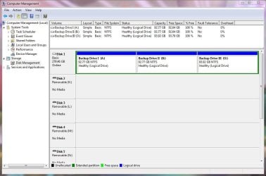

OK..decided just opening bootable CD was no real problem...opened by booting to DVD...the troubled drive did show up...but as the #2 drive...not #3...
The troubled drive ..#2..was NOT marked as active...the only thing I noticed was that the first partition was marked as "Primary"...where as the other data drive (real #3) was "Logical" ? ( did not change anything )
The only operation I ran was to label the C:\ Volume as the Main Win7 Drive...the label was empty (although before this all started...it did have a similar label indication it was the main Win 7 Installation)
Now the weird part...rebooted and removed DVD as main boot group and set to HDD's...Windows 7 started up normally as if nothing at all had happened...appears to be running well with no new issues or problems...all three drives are accessible...BUT...the C:\ drive still does not show up in Windows Disk Manager....but does again in Easeus and Seagate .

Windows boots normally with only 2 SATA drives, but will not boot with 3...
Since both the extra hard drives are the same size, does it make any difference which one is connected to the same SATA cables (i.e. if the drive that seems to work is connected to SATA 4, do both drives work if connected to SATA 4) or does the bad drive keep Win 7 from booting if the other drive is not connected?
The Disk Management picture you show only shows one drive. Where is the second or third drive? Is that what you mean by it won't show up?
What are all the Removable disks? Are there any more disks below what is on the picture, for instance, I do not see a DVD.

Ok...let me clarify...at this point all Sata drives (3) are connected and W7 is now booting normal from the C:\ drive as before the issue started. But...all I did was start "Bootable CD" (with all 3 Satas connected) any the only operation I ran was to name the C: volume label that was empty (which was previously named ) and exited.
With the 3 drives still attached I immediately tried the reboot via HHD in bios and presto...W7 booted normally with all three Sata drives in "Computer" and accessible.
But...W7 Disk Manager still does not show the C: drive. Sata 2 & 3 are there..but not Sata 1 = main C:/ drive with W7 installation ?
The removable K-L-M-etc...are usb ports...not disks.
The 2 DVD's are shown...but the system is running on a 32" LCD TV/monitor...so I can't get the who DM screen in one shot.
I will post back with 2 shots top/bottom...in a little while.
Main issue now is why isn't the C:/ drive, Disk 0, showing up in DM...does it matter...?
Shows in both Seagate Disk Wizard, Easeus, and also did in Windows "Bootable CD" when it was running ?
I suppose I am a little dense, but usb "ports" do not show up in disk Management. Are these card readers or something along those lines? Can you unplug something?
It does seem a little strange the primary drive would not show up in disk management. I can't remember right now, but you do have it first in the drive order in the bios? Which probably means it should show up as the hard drive in the boot priority.
