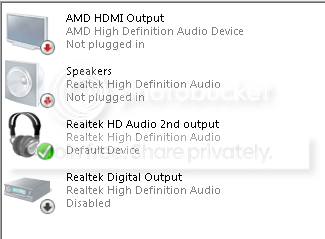

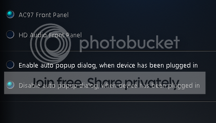

When I switch this to AC97 in the sound manager:
My Playback devices will look like this(The headphones don't work still)
-When I switch the connector settings to HD Audio my headphones don't work still and they are not detected, does that mean anything?
-Also, when I take all my devices out and put them in one by one, the audio manager doesn't notice me plugging in the headphones.

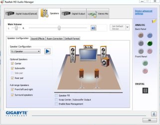

Also check the RealTek HD Audio Manager to see if anything is not set up correctly. On my RealTek HD Audio Manager, Device Advanced Settings, I have an option for how the front panel headphone jack works. See screen shot.

The only options I have in my audio manager are for my playback devices, the connector settings in the previous image, and these:
That Audio manager is different than what I have, on both my Gigabyte motherboard (what I posted) and on an ASUS Z77 motherboard. The ASUS has about the same audio manager as my Gigabyte.
The check mark for "Make front and rear output devices playback two different audio streams simultaneously" may be an issue. What different "streams" is it going to playback?
