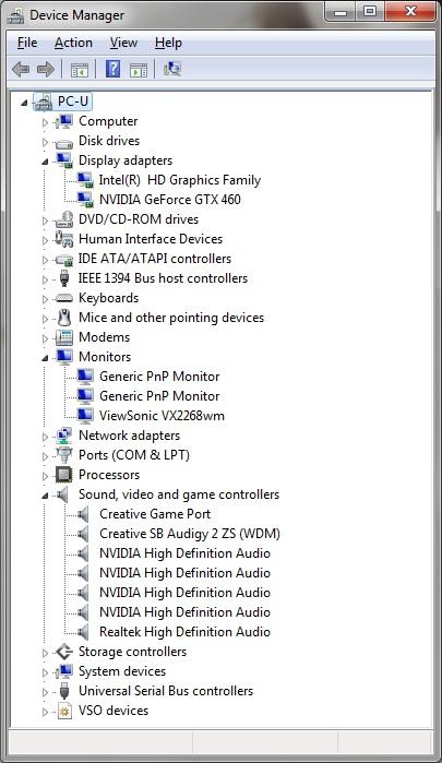

I have both onboard sound (Realtek AL892) and the Audigy 2 zs installed and enabled, they both work fine and will output audio according to which ever playback device is set as "default".
http://image.bayimg.com/caihnaadf.jpg

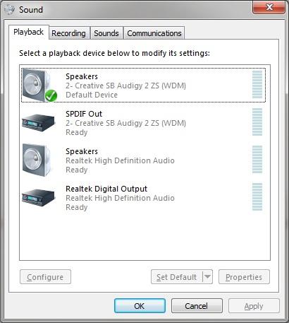

Problem is, there is no audio via hdmi to my Philips 6605 LED TV
- No device detected in "Sound - Playback Devices" so I am unable to select it as default audio playback device.

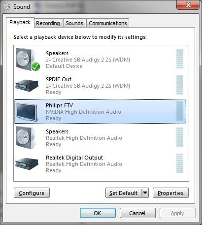

However if I were to connect the Philips 6605 LED TV to the Geforce 460, I am able to see
"Philips FTV-1" in "Sound - Playback Devices" and enable it. And the TV will output both video and sound.
http://image.bayimg.com/daihbaadf.jpg
Any advise on how to get the onboard video detect the TV? So I can bitstream audio as well as video over HDMI?
I would prefer this setup(onboard video to TV and geforce to 2xmonitors) rather than having the TV+viewsonic-monitor on the Geforce.
