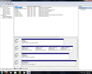

Here you go:

Boot is the partition you are currently booted into. System is the partition containing the boot critical files. 7 won't make a boot.ini on the root of the drive.
If you messed with the original XP boot.ini - put it back exactly the way it was.
I would assume the bios boot order has cdrom first, Disk0 second.
Try this:
From within 7 ( with the dvd in the drive) - as you are now, in fact.
In Disk Management, rt click the IDE partition and assign letter J.
Open an elevated command and type:
bcdboot c:\windows /s j:
then press enter
H:\boot\bootsect.exe /nt60 j: /force /mbr
then press enter.
Remove the dvd from the drive and restart.

I had a sneaking suspicion you would look at that IDE drive, as I started wondering about it myself. I'll try all that and post here whether it works or not. Either way, I thank you for your help.
W7
I ran into a problem right away. I can't copy the boot files from the IDE...it's not quite working for some reason (says failure to copy). I haven't used that drive in a long time now because it was acting up. It has my original XP on it. I had cloned that drive to the XP partition on that SATA drive. Apparently my machine has been booting from the IDE all this time? At any rate, if I click on the IDE in explorer it show 0 files, but looking at properties it shows full. So my question is, can't I just format the IDE (assuming it will let me)? I really don't care about the data on it any more. If I do this, in effect destroying the bootfiles, would the repair feature on the disc fix my problem?
