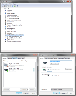

My problems began after I clean re-installed W7. My rear audio jacks are not being recognised in device manager, and plugging in my headphones won't help. I disabled my front audio panels, because the front and rear jacks cant be used at the same time and my rear jacks have surround sound options, so I'm using those.

- Looked at Device Manager, see screenshot.

See how there's only 2 devices listed, where there I guess should be 6 jacks listed as well. This doesnt change when plugging in my headphones.
The fact that nothing shows up in my device manager and audio device manager is something I haven't seen yet when googling my problems. :confused: Also the fact that the downloaded drivers don't seem to work bothers me, maybe I'm using them wrong? I usually extract them from .zip files and then run setup.exe

Ah ok interesting, but I already tried uninstalling the drivers from the listed audio devices and rebooted: it didn't work.
However, those devices (S/PDIF and HDMI) aren't part of the audio device that is causing problems.
I think the main problem is that somehow the sound card/chip that is built in my motherboard doesn't show up in the sound device panel.
As for the jacks, even if they would be broken, wouldn't the sound system be popping up in the devices /sound devices panel? Also note that I used the jacks for 4 years every day before they stopped after installing windows the next day

You need to install the audio driver from the link you posted. That it is showing as "high definition audio device" says the it is using the default Windows driver (which provides just enough functionality to get sound), and not the proper driver (Via according to the specs for that motherboard).

Stormy, I did that, but it didn't change anything. When I open the driver I get an UAC pop-up, but then nothing happens. What bothers me is that the jacks don't show up in the sound device manager, as if they don't exist. Even after plugging in my headphones, nothing shows up and I don't get any sound
