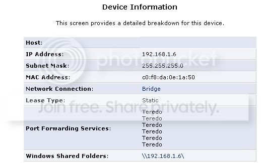

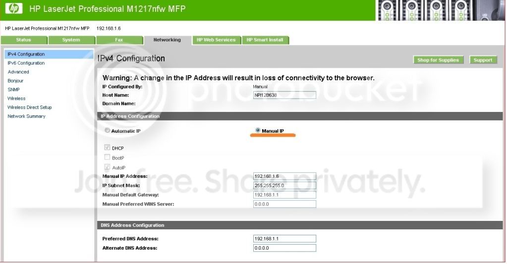

Serpentracer:
Thank you very much for your comments. Yesterday, I was able to do another "experiment" with a third laptop. This was a brand new HP belonging to my son who happened to be visiting. We popped in the HP printer disc, installed the software and he was printing wireless from his laptop in minutes. So, I am confused, Out of three laptop computers, mine is the only one that will not allow wireless printing. The other two are perfect.
Just noticed this:
Looks like a static IP all along. What now?
windows 7 professional
Sony VAIO VGN NS305D
:D
Hooray! Problem solved. Actually, I stumbled across a possible solution. I read on another computer related forum that certain security software can cause problems with wireless functions. Just for an experiment, I disabled my AVG firewall. Then I instructed the printer to print a test page AND IT DID!!! When I opened the detailed firewall settings, for some reason the default setting had spooler.exe turned OFF. I changed this to ON and now I can print wireless. I went back to the HP troubleshooting site and could find no reference regarding the firewall setting as being a possible source of trouble. This really surprised me. But, now it's fixed.
Thanks for all of the great suggestions!

Serpentracer:
Just noticed this:
See where it says Host Name in the first screenshot? That's what you would use to map the printer instead of the IP.
