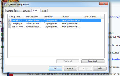

Try Clean boot,
http://www.sevenforums.com/tutorials/179159-troubleshoot-application-conflicts-performing-clean-startup.html
Click Start and type in the search box,
msconfig
Click on the suggestion on top or hit the Enter key,
Go to the Startup section and take some screen shots for a complete list,
Go to the Services section and on the bottom left Check the box to Hide All Microsoft services,
Repeat the screen shots,
See the links above my signature on how to take and upload screen shots here,

Thanks for your immediate response. I have attached 2 pics of msconfig of hiding all Microsoft items and startup to this.

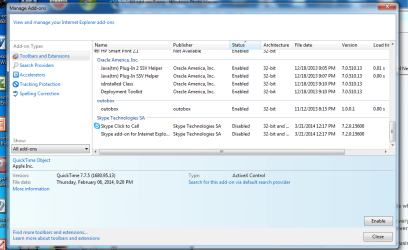

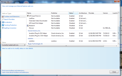

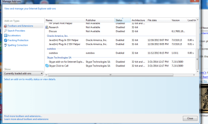

I have attached 3 pics of the addons to this posting.
I did not reinstall the printers at all with the current version of ie11. It worked fine and dandy with IE8

Hi thanks for the additional information,
Unfortunately the manage add-ons page is set on Currently loaded and not on Show all,
Please redo those screen shots,
In any case all of the h-p add-ons are unavailable which would indicate they or your printers will need to be re-installed :(
I would also uninstall Java from Oracle or at the very least make sure it's Disabled unless you actually need it via a prompt on a webpage but quite frankly I have never seen a need for Java ?
In addition you might re-install Last past toolbar using the current version of ie10- or 11

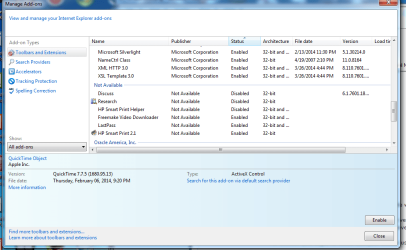

Hi

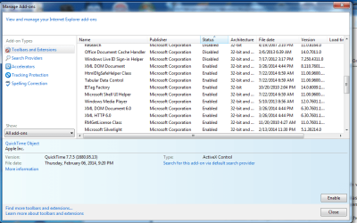

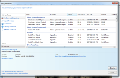

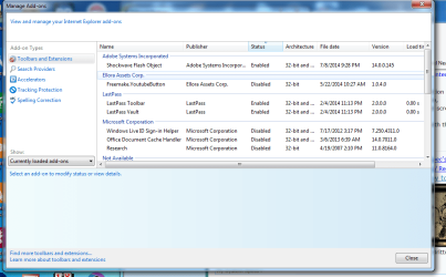

Sorry I did not send u the proper screen shots. I have now added the full add on list of things in IE11. I have attached all 5 pics to this report.
I will look into why HP is disabled.
OK, I have java disabled np
Why would I need to reinstall the last toolbar?
Thanks

Hi thanks that is a list :)
Temp files delete,
Run this as administrator and Start the scanner,
Shut your machine down after it finishes,
http://www.geekstogo.com/forum/files/file/187-tfc-temp-file-cleaner-by-oldtimer/
Personally I would follow this reset process from the start menu search with all browser windows closed,
Reset process first opening Internet explorer
Once you double check which add-ons are still enabled after reset/ there should be only One if you follow the instructions = Flashplayer,
Attempt to print without enabling anything third party related toolbars Especially ;)
