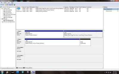

We can advise you better after seeing the Disk Management screenshot. Use the Snipping Tool in Start Menu, attaching file using paper clip in reply box.
It is likely a matter of marking Win7 partition active using Partition Wizard bootable CD or Diskpart, then booting the Win7 DVD Repair console to run Startup Repair up to 3 separate times with reboots, to repair or rewrite the MBR to Win7.
You can then deal with any partitioning or dual boot issues.
But let us see the screenshot first to be certain of any advice.
Okay here is a screenshot.

Correct. I now get the disk read error on the 7 HD. So basically, I need to figure out what is causing the disk read error and get it so 7 boots from my sata hd.
