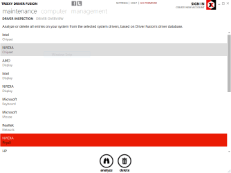

The last option would be to download and install Driver Fusion and use the analyze and delete function for physx. Drivr Fusion was once known as DriverSweeper
ie

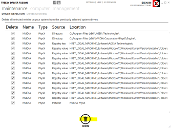

Select PhsyX>Analyze
Delete
Create a manual Restore Point before hand, just in case.
(Watch the Driver Fusion installer. There is an additional app option attached you need to untick.)
You should now be able to install physx.

When I have the time I will try Driver Fusion, but I'm kind of confused when you say
So I did as you said, but there was nothing to remove, but it allowed me to anyway. I did so, restarted, tried with all things selected and it failed: http://i.imgur.com/2f2Fn.jpg
