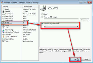

I'm going with the dual boot method. I already started by shrinking the HD and adding new partition D, changed CD drive to E. Have not completed total transition. Need to use virtual PC, but now won't recognize CD drive. Went in and changed drive letter in virtual mode but no difference. Only thing I know to do is go back to Win 7 and change CD back to D and new partition to E.

Open XP Mode Settings:
  • Browse to folder C:\Users\Your_Username\Virtual Machines (default location)
  • Select Windows XP Mode, right click it and select Settings
When Settings dialog opens:
  • Select DVD Drive on the left pane
  • Select Access a physical drive on the right pane
  • Select the new drive letter of your CD/DVD drive from the drop down menu
  • Click OK to save settings
This tells XP Mode that you have changed the host system CD/DVD drive letter, no reason to go back disabling changes you have already made.

Kari: Thank you. When I pulled up the settings it already had the right letter, just needed an OK I guess. Works fine now.
