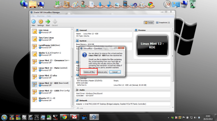

What do you mean by you found Ubuntu deeply entrenched? When you remove a VM from Virtualbox you are asked if you wish to delete the files. If you do so then it is gone usually. Sometimes the delete will fail and you have to do it manually.

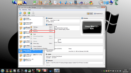

The correct way to do it is...
Right click and select remove.
When asked press delete all files.

So to remove the guest, right click the one you want, click remove and follow up with remove all the files.

No you just right click the vm name in the left hand pane.

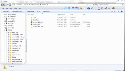

VBox creates a folder for each VM with two main files in it The first is a .vbox file which contains the settings for the VM. The second and much bigger file is a virtual disk, usually with the .vdi extension. This contains the installed guest and all its data. There are various other files and folders but those are the important ones. The folder by default resides in your documents folder although you can change that. I have moved mine onto an external disk as they are quite large. This is the folder for my Ubuntu VM.
