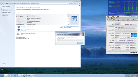

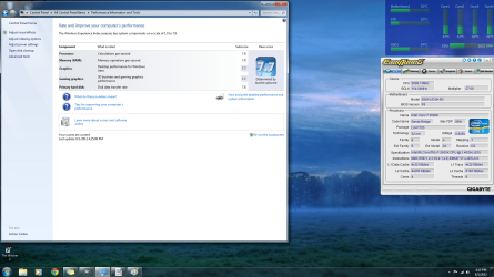

I've attached some photos of my Windows Experience Index before and after using the Easy Tune utility to OC.. The picture i took before i OC'd was with turbo boost off, though. Was suppose to be 7.7 not 7.6 .. After enabling TB in the BIOS and overclocking it jumped up to 7.8 ... Used easy tune to put Turbo Boost @ 4.3Ghz (According to what right clicking on My computer tells me.)

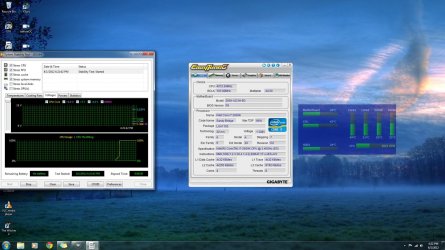

I've used an overclocking tool for the Turbo Boost feature on the i7 called Easy Tune. I downloaded it from the manufacturer of my Z68X-UD3H-B3. Check it out here. I am new to overclocking but the program seemed user friendly enough to use, and it was only effecting turbo boost feature. Plus i knew how to reset to defaults in BIOS so now biggie.

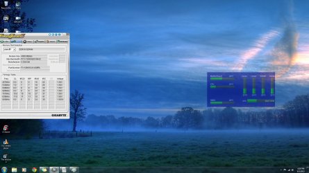

Based upon what you guy's see in these attachments, are my RAM readings OK? Anything you see i should watch for or i can improve on? Any other info i can give to help determine these things?
I've used Aida64 to monitor my temperature and perform a stability test. Highest temperature for the cores was 60 Celsius and that was only for a moment while OC'd. Highest for the overall CPU Temp was 46 Celsius. Correct me if i'm wrong but these temperatures are awesome, isn't it? I only did a 5 minute stress test with Aida though...
None of those screen shots show what the actual ram timings are. Download CPU-Z and post a pic of the memory tab.
ie:
Temps are fine - but 5 mins is woefully inadequate for a stress test.

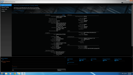

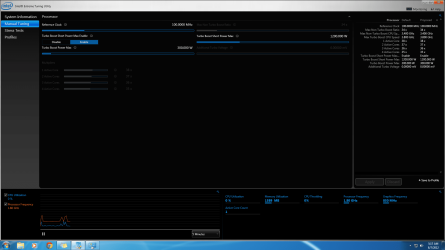

Got any screen shots of how i would do the multiplier thing in the BIOS? i've gotten to know it well but i do not want to mess this up, i'm sure you understand.
I used easytune and it seemed to give me issues... motherboard said it ran in to issues restore to failsafe defaults, etc... so i did that.
Then i found the setting the reduces something so that when u overclock it improves performance, sorry i dont know the name of it, exactly unless i was in the BIOS. i know its in the Tweaking section where the overclocking stuff is...
I would like to know how to use this utility. It seems a little more advanced butits made by intel, so maybe i will have better luck.
I've also attached a screenshot of it installed on my computer. maybe you can look at it and see if it contains that other info u said need to watch out for asides from the temp, the CPU Voltage.
