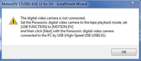

I’m trying to also get my Panasonic NV-GS75NV-working with my Windows 7 64 bit PC and am really struggling. To start with I can’t install MotionDV. The version that came with my camcorder is 5.3LE. I’ve downloaded version 6.0LE from the Panasonic web site but I can’t get that installed either because half way through the install I get an error message "the video camera is not connected" - see attached. When I plug in the camera it appears as a Web Cam in Devices and Printers and has the label DVC. I’ve tried installing the USB and video streaming drivers but again they won’t install. In device Manager it appears as 'Video Edit' under imaging devices.
Please can someone provide some thoughts on how best to proceed?

You don´t explain very well the resolution of the problem. I connect the camcorder to pc and change in the camera to play tape. then with motion dv open i desconnect the cable and connect again and voila. Works perfect!
This is it, indeed, when installing the software and when he gives the error that the camera isn't connected, just unplug the cable, plug it right back in and voila: it works!
