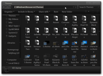

Do the themes show up in Personalization?
Take a screenshot of C:\Windows\Resources\Themes and post it.

Yeah they show up, but they're all black.
