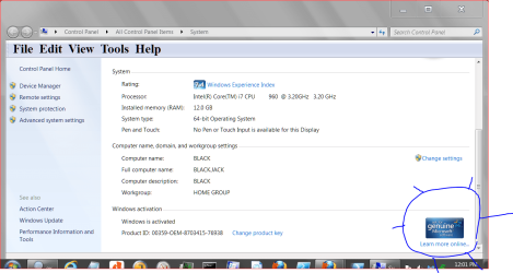

Make sure your system is still activated properly. If you don't have this you could have problems like you are having

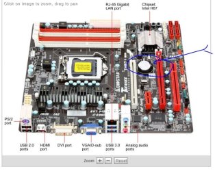

I have been reading this thread for a few days. Is this a desktop computer or a laptop computer. Ususally on a desktop it is the CMOS battery that is about the size of a quarter. Battery # CR-2032 .
on motherboard

So is the battery I showed in the pic the one you replaced with a new one ? In the Bios, the arrow keys move you between the different fields. The + & - keys will chane the date & time either forward or backward.

Just hit the Windows 7 Flag key and the pause key on your keyboard and post the picture here.
its in post 12
yes that's right that's the battery,ok when i switch on the PC il try to fix from bios,then well see.

I see no picture in post #12
Have a nice day.
why should i post a picture?as i said i have the genuine mark,in yes i do have that m8.you don't believe me?
