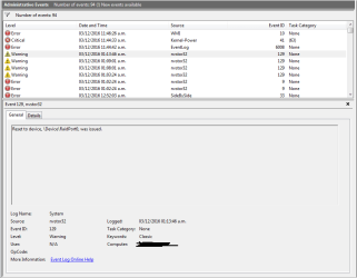

Hi, i will tell the story from the begining, i had only 1 HDD, with the same problem im having now, then i got another hdd because i tought the problem was the disk, but it keept happening, as i am writing now it freezes for few seconds,okay then i went to event viewer and found this nvstor error, which is from the hdd driver, i changed the driver and everything started working perfectly, last week the problem started again, then it showed a message saying:"disk will fail" or something like that, i ignored it but when i got home a few days ago it did some ugly noises so i turned it off, now im using the "new" hdd and i installed the drivers from the motherboard -ecs geforce 6100pm-m2- but keeps freezing, i go to search folder and it loads and freezes for a while, event viewer says this:
Reset to device, \Device\RaidPort0, was issued. nvstor32 event 129
help please!

Run System File Checker. On a CMD type: sfc /scannow
For the disk, schedule a disk check. On a CMD type: chkdsk c: /f. It will ask if you want to schedule on next start. Yes.
Disk noise and alerts aren't good news. I think your disk is dying. If disk check finds bad blocks or bad clusters, It will die soon.
Anyway, it's better to be safe than sorry. Backup your data.
Buy a small 120G SSD an put the OS and programs on it and use a HDD for \Users (data)

thanks for replying, i ran the chkdsk, but when i run sfc /scannow it says Windows resource protection found corrupt files but was unable to fix them.

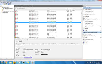

okay, when i ran the diskcheck computer started working fine, i also installed the correct drivers, i did the repair install, pc doesnt work perfectly but is usable, sometimes it gets slow but its okay, now when im playing a game it freezes so many times is unplayable.
here is a screenshot, about 3 o clock i started gaming, but i can play other games very good

Did check disk found bad blocks or bad clusters?
Follow these steps to view the Check Disk (CHKDSK) results:
Open the Control Panel
Open Administrative Tools
Select Event Viewer.
In the Event Viewer expand the Windows Logs
Select the Application log.
Right Click the Application log and select Find
Type wininit in the box and click Find Next
In the middle pane click the Source/wininit line that is found.
In the south pane, you will see the complete log for the latest Check Disk (CHKDSK).
I think your disk is dying. If disk check found bad blocks or bad clusters, It will die soon.

thanks for helping, i clarify that im using a different hdd than the one i mentioned before, the one i have now when the problem started it also started making noises, it doesnt anymore. i disabled windows update and windows defender but still game freezes, this is the chkdsk log:
Checking file system on C:
The type of the file system is NTFS.
A disk check has been scheduled.
Windows will now check the disk.
CHKDSK is verifying files (stage 1 of 3)...
Attribute record of type 0x80 and instance tag 0x3 is cross linked
starting at 0x27864f for possibly 0x1 clusters.
Some clusters occupied by attribute of type 0x80 and instance tag 0x3
in file 0x12881 is already in use.
Deleting corrupt attribute record (128, "")
from file record segment 75905.
starting at 0x304953 for possibly 0xd clusters.
in file 0x128e9 is already in use.
from file record segment 76009.
86016 file records processed. File verification completed.
121 large file records processed. 0 bad file records processed. 2 EA records processed. 88 reparse records processed. CHKDSK is verifying indexes (stage 2 of 3)...
The file reference 0x3000000012d86 of index entry 839.tmp of index $I30
with parent 0x124bf is not the same as 0x5000000012d86.
Deleting index entry 839.tmp in index $I30 of file 74943.
Unable to locate the file name attribute of index entry CRX_INSTALL
of index $I30 with parent 0x124bf in file 0x12e90.
Deleting index entry CRX_INSTALL in index $I30 of file 74943.
Unable to locate the file name attribute of index entry CRX_IN~1
Deleting index entry CRX_IN~1 in index $I30 of file 74943.
126950 index entries processed. Index verification completed.
CHKDSK is scanning unindexed files for reconnect to their original directory.
Recovering orphaned file SCOPED~2 (74943) into directory file 32852.
Recovering orphaned file scoped_dir_2544_10146 (74943) into directory file 32852.
Recovering orphaned file F87C.tmp (75905) into directory file 32852.
3 unindexed files scanned. CHKDSK is recovering remaining unindexed files.
1 unindexed files recovered. CHKDSK is verifying security descriptors (stage 3 of 3)...
Repairing the security file record segment.
86016 file SDs/SIDs processed. Cleaning up 250 unused index entries from index $SII of file 9.
Cleaning up 250 unused index entries from index $SDH of file 9.
Cleaning up 250 unused security descriptors.
Security descriptor verification completed.
Inserting data attribute into file 75905.
Inserting data attribute into file 76009.
20470 data files processed. CHKDSK is verifying Usn Journal...
27225480 USN bytes processed. Usn Journal verification completed.
Correcting errors in the master file table's (MFT) BITMAP attribute.
CHKDSK discovered free space marked as allocated in the volume bitmap.
Windows has made corrections to the file system.
100409343 KB total disk space.
16593480 KB in 63331 files.
47812 KB in 20470 indexes.
0 KB in bad sectors.
182199 KB in use by the system.
65536 KB occupied by the log file.
83585852 KB available on disk.
4096 bytes in each allocation unit.
25102335 total allocation units on disk.
20896463 allocation units available on disk.
Internal Info:
00 50 01 00 65 47 01 00 2a 9a 02 00 00 00 00 00 .P..eG..*.......
8a 00 00 00 58 00 00 00 00 00 00 00 00 00 00 00 ....X...........
f8 8b 32 00 50 01 31 00 b8 18 31 00 00 00 31 00 ..2.P.1...1...1.
Windows has finished checking your disk.
Please wait while your computer restarts.

i should say that only the game League of Legends freezes constantly, i play cs go and runs fluid

Did you see how many logical errors your disk had?
I would reinstall the League of Legends.

i reinstalled but it kept happening, i kinda found the problem, i noticed that when i disable pagefile.sys the game runs smooth like heaven, so i think that the problem is when the game goes into pagefile, i have only 2gb of ram so i need the pagefile, is there any way to prevent the game from going to pagefile?
