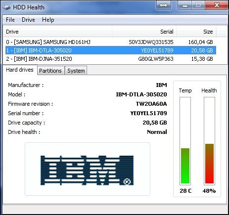

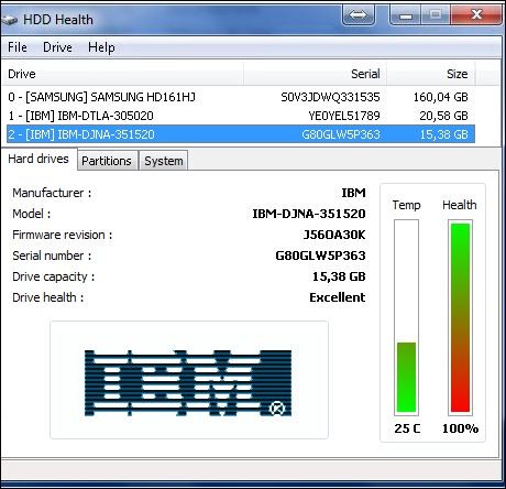

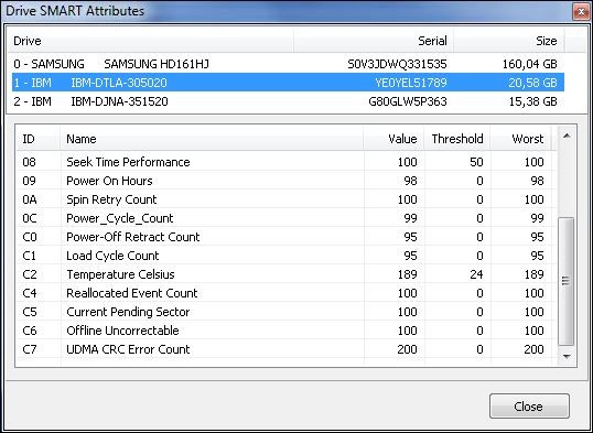

The motherboard is ASUS P5V-X SE
CPU is E4500
Disk #1
Disk #2
Disk #3
When looking closer to the disk #2 that is the weakest of all ->
Windows 7 Ultimate
Windows 7 Ultimate
