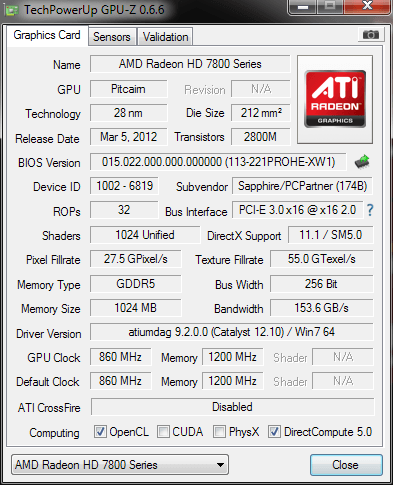

Hello,
I have Asrock Z77 Extreme4 Mobo + i3 3220 Ivy bridge CPU. I've just added a Sapphire HD 7850 to this and I was expecting it to run @PCI-e x16 v3.0.
But GPU-z reports it's working @x16 v2.0
How can I fix that?

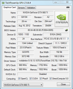

I have the same motherboard, but an Nvidia GPU. I didn't alter any settings after installing the motherboard and GPUz reports mine as being PCI-E 3.0
I will have a quick look in my bios to see how things are set.
Edit, scratch that, yes what Dwarf said, mine see my screenshot.
Paul.

I've already set it to Gen3. No difference. There is also this:
When I open the Catalyst control center hardware tab. It also shows that Maximum Bus Setting is PCI Express 2.0 x16
Is this normal for 7850 ?

GPU-Z shows @x16 1.1 when idle. Steps up to x16 2.0 when running GPU-Z render test.

Downloading Heaven now. GPU-Z render test stepped it up to v2.0 only :(
I'm also bugged that Catalysts shows the card's Maximum Bus Setting as "PCI Express 2.0 x16" :(

Good point, I was thinking about it earlier in the thread but got tied up in looking into if it was actually running at 3.0 for him.
Not that its important, but here is a screenshot of when I have Heaven running in windowed, as you can see it's changed from 1.1 at idle to 3.0 just as Dwarf said it would.

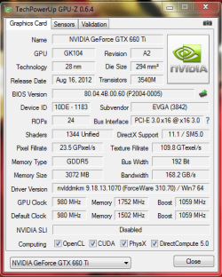

What do you get when you run the GPU-Z render test? up to v3.0 from 1.1 ? or just to v2.0 as I do?

Give me a min to test.
Edit, tested, goes straight to 3.0 as soon as the test starts.

Mine still goes up tp v2.0 while running Heaven :(

Take a look at the following links. Scroll down to the section Expansion Options and note what it says for PCI Express Revision.
My CPU: ARK | Intel® Core
Your CPU: ARK | Intel® Core
According to the above, your CPU only supports v2.0 whereas mine supports v3.0.
