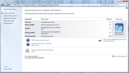

Dealt with some buyers remorse but I'm pleased so far. Card is literally 3x the size of the old card. But luckily that didn't block any sata connections so no changes there, did have to reroute two m/b header pin connections no big deal and the 6-pin power adapter (included) came in handy.
No fps comparison to report but I can say I cranked up settings on one game w/heavy mod to high and it seemed fluid. Where before on med the old card was challenged.
Prior to the upgrade
Current
