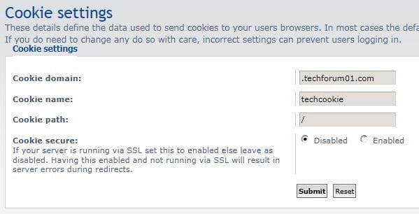

My cookie settings are:
Can anyone advise how to get the cookie settings working correctly so we don't keep getting logged out??

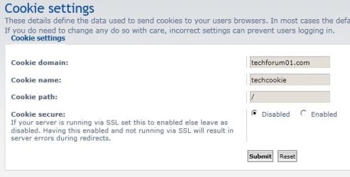

Hi TCG,
Thank you for your reply, unfortunately this hasn't fixed it :( or i am missing something?
Accessing via http://techforum01.com
I can still see the SID in the URL, is this normal?
Cookie Settings:

In the ACP, make sure that the "Cookie Domain" set in Cookie Settings is the same as "Domain Name" on the Server Settings tab. Perhaps they are different? While you're there enable "Force server URL settings" if it's not already.
I just did a test install here with the exact setup you have, url included. I'm able to post links and click them without breaking login so it's surely something with your setup/config. Possibly you have a remnant cookie still causing this behavior?
- To answer: Seeing the SID is normal behavior for phpbb3, nothing to worry about there.
