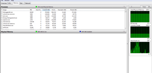

Is this a memory leaks issue? I checked the forum for the possibility of any type of memory leaks
from this here http://www.sevenforums.com/crash-lockup-debug-how/102606-memory-leak-troubleshooting.html
seems to me that there is a memory leaks issue on my laptop. here are screenshots that you may need to have a general overview of the situation.
the commit size still do not add up when its added. I would assume it's something related to the actual harddrive? (the RAM being bad?) but I don't know for sure.
Any help would be appreciated!
UPDATE: I included a .txt report from CPU-Z for a more specific Hardware specification / information

is it normal to have a physical memory usage at around 170 - 180% of the commit charge?
here is a ss from the resource monitor
after i calculate it, the commit charge adds up to the total commit written on the table, while the physical memory (private usage / working KB / shareable KB / commit charge) does not add up to the total physical memory usage....
does this mean something?

Adding all the uses of your ram and comparing is kind of a waste of time.
As far as I know their is no way to see or measure everything that is using a little ram here and there.
Did you or did you not read and understand this?

See if you can get an idea from this thread - http://www.sevenforums.com/performance-maintenance/89643-memory-leak-not-process-explorer.html
Your Nonpaged is higher than it should be I believe, we have experienced people that may guide you. My 12GB laptop has only 174MB nonpaged while 4.33GB is used.

here is the result after i left my laptop on for a while (clean boot)
which means that the problem might be related to the drivers / OS instead of the application? (I do not know please do enlighten me if my assumption is unfounded)
edit: i have uninstalled QQ and will try and see whether the issue still persists.

thanks for your help and assistance everyone!
there was a leak in the non-paged pool (it did not wipe the process after its stopped so the memory is kept until its clogged up and deplete all of the available RAM.
i dont know what caused this but i decided to just do a clean install and its fixed now.
