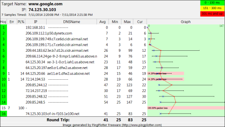

So you did the pinging. So what's the problem?
It's not unusual for pings to be all over the place unless you have exclusive use of the routers from your location to the site. What did you use for the ping test?
I just ran one and it's showing packet losses. Could be a router problem somewhere.

Let me get this straight--Your network is connected directly to Google servers? Are you inside the Google building?
Run a ping plot and you'll get a better idea of where your traffic is going. It returns a ping from each server in the message route. You'll should note that network traffic can get bounced all over the world just to get next door. It just depends on network load. There's a lot of load on the network now. MS just released a ton of updates.

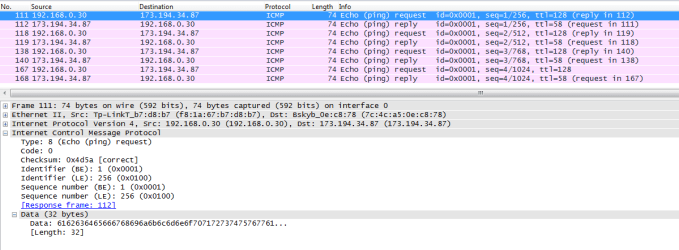

By connection-less I am referring to whether an identifiable connection can be established. Another post suggested that Google may be performing traffic shaping techniques by queing the traffic before processing. In a connection-less application like ICMP there is no way to uniquely identify each echo request and reply. If traffic shaping techniques had been enforced then other people who ping Google would experience the same spikes. I didn't which makes the validity of this questionable but not completely invalid. This is the reason why I sent the ping messages myself. My intentions had nothing to do with the path taken to the server.
If you look at a wire capture of a ping you can see that no uniquely identifiable information is exchanged and no keep-alive messages are sent either since there is no formal connection being made.
This is as opposed to TCP based applications which does establish a unique session (Also known as a Socket). This would then make QoS enforcement on a particular connection more feasible. An example of a TCP connection being established can be seen below:

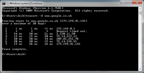

A traceroute is good option however when using it on the internet it can be rather decieving and will not show the full picture. For example, a traceroute for me says that Google is 7 hops away. So that would mean that my ISP has less than 7 routers in the path to Google? No possible. Traceroute relies on the TTL being decremented in order to offer an accurate reading. As for the latency times... it could offer a suitable reading to see if a router in the path is causing extortionate high spikes in latency however again not all routers are recorded in a trace. Additionally, traceroute works by sending ICMP messages with low TTLs and receives feedback based on the ICMP TTL Expiration messages. The latency involved would not be accurate to a routing lookup as the router involved would need to create a new packet to send back where as in normal transit traffic it will just need to perform a route lookup and send the original packet on its way.

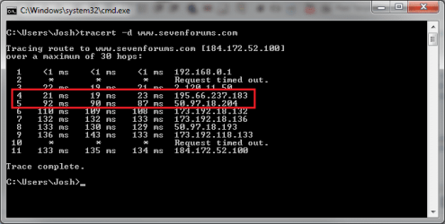

While a ping can't tell you everything it doesn't mean you can't break down the path that is being taken and identifying potential variables that could cause the issue. Starting from within the local network helps to prevent unnecessary calls to an ISP on fixing an issue that may be local to a particular machine.

You'll have to explain what you mean by a "formal connection". You don't need a session for a server to respond to a frame but there is a connection established. The server will respond to a frame. That frame has a source address and a destination address. The response is really an error response (time to live = 0) but the server does respond. It's in your example called a "reply". It can't respond without knowing where to send it. Formal or not, that's a connection. The ping software just doesn't pull a number out of a hat. :rolleyes:
By a "formal connection" I mean a full session being made between client and server with record of that happening. The second image in my previous post shows a TCP three way handshake taking place and causing a connection to be established. If you run the following command in a command prompt it will show the various connections that are established.
netstat -a
ICMP doesn't appear because it doesn't establish a session before sending the echo requests and is therefore known as a connection-less protocol. If you've ever had any experience with UDP you will notice that it is also known as a connection-less protocol since a connection isn't technically established. For example, consider DNS which uses UDP port 53.
The response is a designated type of ICMP message dedicated for echo-reply functions (ICMP type 0). TTL Expiration messages are of type 11. The reason the server replies was because the destination IP address and layer 2 address on the other side matched the one of the server therefore it read the whole packet. The only time a TTL expiration error message is legitimately used is in traceroute ;)

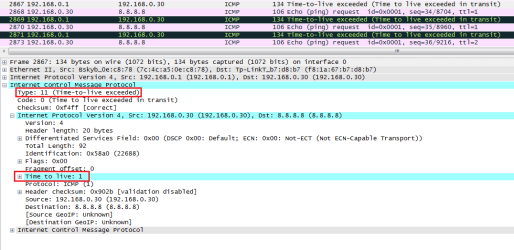

TTL expiration is used for traceroute messages as that is how it determines what hops are in the path.
The server knows what IP address to send the reply message to but an IP address isn't 100% unique. Consider the implantation of NAT (Network Address Translation). Many devices could be using one public IP address when accessing a server. With ICMP the unique information is handled via NAT but from a server perspective it will not know the NAT table mapping and therefore only has an IP address to go by.

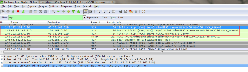

With something like TCP, which establishes a connection, there is a unique source port generated by the client in the process and therefore offers something that can uniquely identify each individual connection. For example, a session from the following socket:
200.12.35.6:34562
Can be seen as a different connection than:
200.12.35.6:40023
With ICMP there is no source port made therefore two pings coming from the same IP address cannot be distinguished from each other.

However when performing a trace to a device that is far away from me, For example, Sevenforums which resides in the US, you can see a clear difference in the path that shows when my traffic left my geographical region and went across the pacific to get to the US.
As you can see the latency between hop 4 and hop 5 increases by about 50 ms.
In terms of exact pin-point of where the increase began at a link level... not possible. At least not on the internet. For an enterprise network there are management and reporting tools that tell us about the link statuses for us. On the internet no one single entity owns a particular link therefore no-one is authorised to monitor its status.
Additionally, traceroute doesn't show every hop in the path to reach sevenforums. There were probably close to 100 different routers used to get to sevenforums it is just that a lot of them in the path didn't decrement the TTL value therefore it wasn't recorded as being a hop.
