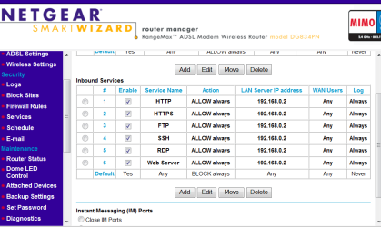

2) set Networking option in the Virtual Machine to BRIDGED (or NAT)
3) Assign specific LAN IP addresses to HOST and Virtual machine.
4) Now set your port forwarding in the router to the INTERNAL LAN address of your Virtual machine.
If you use something like No-IP - Dynamic DNS, Static DNS for Your Dynamic IP its free BTW -- you can also access your VM remotely from OUTSIDE your LAN too.
Here's the setup from my router -- most are similar -- usually you'll find the setup in "Firewall" / Ports or some other setting for your router.
