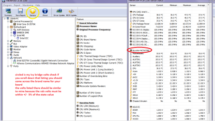

Kerf run this and let us see the rail voltages please
UsingHW Info PSU
Download HW Info and pick the right bit version -
HWiNFO, HWiNFO32/64 -Download -(copyand paste this site into the search bar) If you donot need the runninginformation in the smaller right hand panel close it. Inthe left hand windowclick on the + for the individual device groupings and theywill open out tothe various components.
Go on opening out further until you get to the device itself. click on it anditwill highlight. In the right hand window there will be a verydetaileddescription of that device as in brand, speeds model number etc etcThese arevery detailed and are just what is needed for searching for driversetc.
To getthe PSU volts you need to select the Sensor button circled in yellow inthe picfor PSU testing do the same and scroll down the readout as in my pic towhereit has Nuvoton = yours might be a different section name / title. Postback apic of that please.

The rail voltages may come up in a section that is not titled as in my pic but it will be the section that has Vbatt in it.
