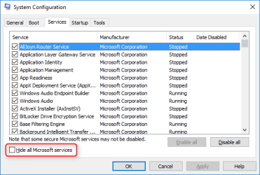

You may knowingly USE only those 5 things daily, but you've got a carload of things going regardless, probably most of them "automatically" when you start up.
How many non-Microsoft services do you have running?
How many things do you have checked off in msconfig startup tab? You need zero to run Windows.
I have a huge list of startup services and all are checked but a large portion of them say they have been stopped.
The one s that are stopped, do i have to uncheck those as well?
Btw, I think you solved my problem.
I have a number of things running right now including 4 tabs open in FF, all of which would normally prompt a memory warning but im at 52% of memory...

Try holding down the windows key and press R. Type msconfig in the search box and press enter, go to the startup page. Uncheck everything you can live without. Nothing but your AV is necessary to run at startup. All programs will run just fine when you need them, they will just not start with Windows and will only be running when you open them.
So it looks like im back up at 70-80% again, even though I thought this was resolved.
How do I know what is "non-Microsoft"?
And are you referring to processes or start-up items?

I've got 11 running and 3 stopped.
Of my 11 running, 6 are Intel, 3 are related to antimalware, and I think the other 2 are unnecessary--I just haven't shut them off.
