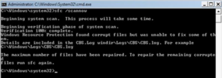

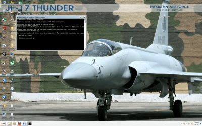

Thanks to both of you to reply me so soon.@marsmimar i have tried scanning my computer as per your instructions but still the problem is there.i am attaching a snapshot of it also.i have scanned and restart my computer more than 3 times.Thanks again

I can't read the command prompt window, it's too small. But I'm guessing it said something like Windows Resource Protection found corrupt files that could not be repaired. Yes, the computer should be rebooted in between each scan. If the files still cannot be repaired by SFC it might be possible to manually replace the damaged or corrupt files. Option three (in the previously posted tutorial for SFC) shows how that's done. You will need a Windows 7 installation DVD (not a manufacturer's recovery disk.) If manually replacing the files isn't an option, you may want to consider a Repair Install.

I can't read the command prompt window, it's too small......
Right click on the image and open it in a new window or tab to avoid the light box - then use Ctrl+ or Ctrl mouse wheel forward to make it big and blurry:-)
It says something like:
The max number of files has been repaired. To repair the remaining corrupted files, run sfc again.
@OP,
Alt + Prnt Scrn only puts the window that is in front (in focus or on top) into the Windows clipboard for you to paste info Paint and save/upload for a post.
