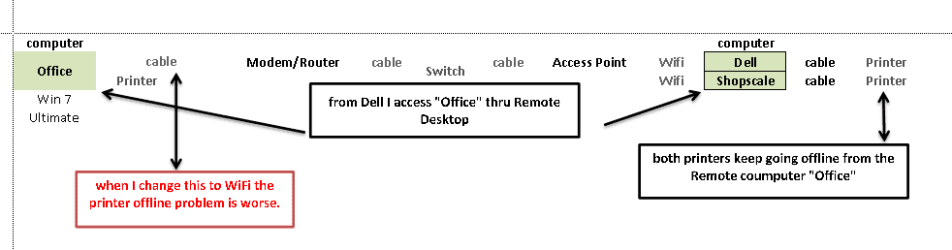

Here is a pic of my setup. I hope this helps. I have searched the web and still not figured it out.:cry:
After I restart the "Office" computer, the prints jobs that didn't print are still in the memory and print automatically to the "Dell" or "shopscale" printers depending on which one didn't print.

I replaced the router ZyXEL PK5001Z Modem that was put in on Jan 5th provided by my internet provider.
it is the one that never worked letting the printers on the network print.
I replaced it with a Netgear that I got at Staples. works like a charm.
