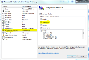

I really do not know where to go next. A bit clumsy workaround until we can find a solution: Check that you have integration enabled, and bidirectional clipboard allowed:
Save the file you want to fax (print), copy it to XP Mode and print from there. Might work?
