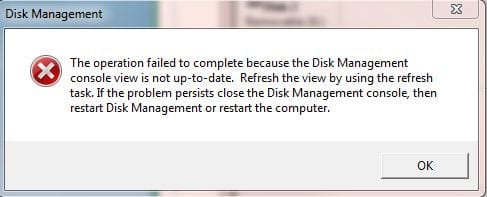

With both drives in and booted up under Windows 7 64, I am trying to access the data files on Vista 32. Unfortunately I dont have a drive letter for the vista 32 drive. I went into disk management to give it a drive letter, but I get an error message when I select drive letter. See attached image.
I tried refreshing and trying again but keep getting same error.

Welcome to the Se7enfourms! 1337Vader
Simply unplugging the data cable from the Vista drive would have been enough to prevent any detection and placement of 7 boot entries on the Vista drive there. Upon replugging in the drive for some reason 7 didn't mount it fully where you could assign a logical drive letter to it.
What you have to do now is intialize the Vista drive while in the Disk Management tool. When right clicking on the Vista drive item seen there you should see the option for that unless the drive is already initialized. Once that is done you will likely need to restart the system before you can assign a letter to it.

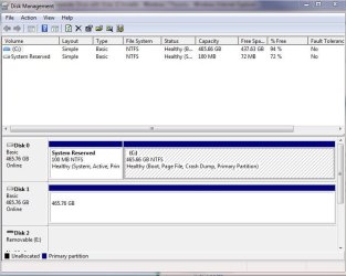

I don't see an option available to initialize. There is a screen shot of the acutal disk manager screen attached.
If I right click the drive space area, anything I choose results in the error message.
If I right click the small "Disk 1" box to the left of the drive space the only options I have are "Convert to Dynamic Disk", "Offline", and "Properties".
I can choose Properties here and it says the device is working properly.
Any other clues?
The next thing to try right off would be going to the menu bar>actions and clicking the rescan option in the dropdown list there. For some reason the existing Vista primary on Drive #1 seen there isn't being properly detected and mounted while 7 is still detecting a working drive.
When removing the drive did you change sata ports by chance when replugging it back in? That's if those are sata models. It sounds like Windows is trying while something still isn't right like a bad port for sata or even a shaky data cable unless the power plug was ???
