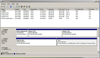

Hello whs & Ignatzatsonic,
Here is a picture of the Windows Disk Management! The first partition is a system partition of 100 MB NTFS. The last (Freecom) is a USB HD.

Good job!
I'll defer to WHS as he is more experienced on this stuff than I am, but at first glance.......
It appears that your System Reserved partition is on Disk 0 and that the C partition is on Disk 1. That's unusual. Normally, you would want System Reserved to be on the same drive as C---Disk 1 in this case.
I assume the image you made is of C only, excluding System Reserved?
There are ways to get System Reserved onto Disk 1 and for that matter there are ways of getting rid of System Reserved entirely. I don't have a System Reserved.
I'd wait for WHS to respond, but your partition situation is fixable.
If you then still have issues with making and restoring an image, that would have to be investigated at that time.

Hello ignatzatsonic,
This picture shows, of course the system with the new installation. The old was different because the system had (raid 1) which I dismantled.
To be honest I did not put the System Reserved partition on Disk 0 and the C partition on Disk 1 intentionally but it just happened automatically during the installation. If you know a better, easier and safer construction then please let me know it and I will change it.

It looks to me that Maybe E: is where you should have restored your image. So when you mount your image (double click on it) how large is the mounted partition?
F: may need to be re sized to accommodate it.

First step to do is make Data D somewhat smaller (unallocated space appears on the rechterkant) so system reserved will fit in the free space. Then copy "system reserved" from disk 0 to unallocated space on disk 1. Make that copy a "primary partition" and mark it active.

Hi Anne,
1. It was the installer that placed the system partition on Disk0. The installer always grabs the disk with the lowest port number for the system partition. The only way to avoid that is to either install the system on the disk with the lowest port number or physically disconnect all disks that are not needed for the installation.
2. The odd setup you have can be easily fixed. I suggest you move (copy) the bootmgr to C. Then you can forget about the system partition and you only have to image C. http://www.sevenforums.com/tutorials/209885-bootmgr-move-c-easybcd.html
3. I have uploaded the latest version of the WinPE recovery disk .iso to my skydrive site. Download the file from there and burn it to a CD - I suggest you use ImgBurn. That seems to always work. Doing it that way as compared to producing it from Macrium saves you a few hours.

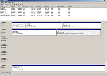

Hello WHS,
Thanks for the information. I downloaded and used the (EasyBCD 2.1.2). According to the EasyBCD is the backup successful. Now, I am having a file in the C drive called (EasyBCD Backup (07-27-2012)). I do not see any changes on the picture of the Disk Manager! Do I have to do anything else or that is it. Is the odd setup fixed now?

C is marked ACTIVE now in disk management?
Hello Kaktussoft,
Thanks for your reaction. Indeed, you are right! Now the C drive is marked (Active) as you can see in the new picture of the Disk Management.
