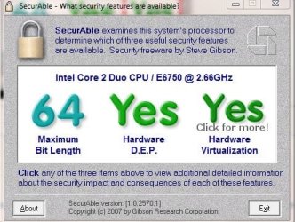

Download SecurAble and run it. What does it tell you?

Here is my screenshot after running securable.exe

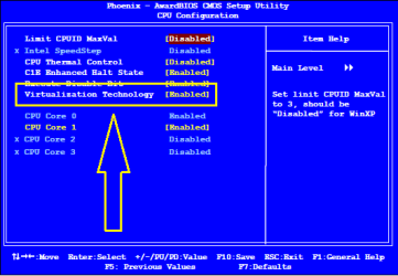

OK, I checked the manual of your MoBo and BIOS, there's only this one switch to be enabled:

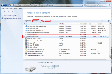

First, uninstall Windows XP Mode normally from Control Panel > Programs and Features:

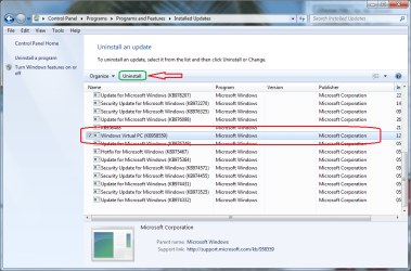

When XP Mode is uninstalled, click View installed updates in the left pane in Programs and Features window. Scroll down to update Windows Virtual PC and click Uninstall:
Reboot, go to http://www.microsoft.com/windows/virtual-pc/download.aspx and download & install both Windows XP Mode and Windows Virtual PC. Please notice the installation order:
