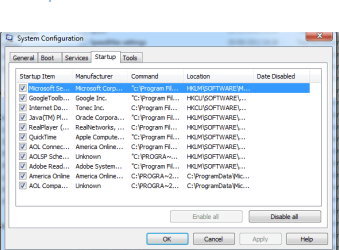

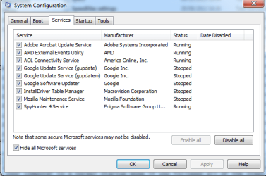

Thanks, I tried the clean boot but still no internet access except in safe mode. Any more ideas?

Hi thanks for the screen shots,
I would uncheck these items from the startup section,
I would also see what No add-ons mode would do,
Add the Run box to the Start menu list you can also use Winkey+R to open the Run box,
http://www.sevenforums.com/tutorials/559-start-menu-add-run-button.html
http://www.sevenforums.com/tutorials/265-start-menu-customize.html
Open the Run command and Paste either of these strings into it and Okay,
"C:\Program Files\Internet Explorer\iexplore.exe" -extoff
iexplore.exe -extoff
