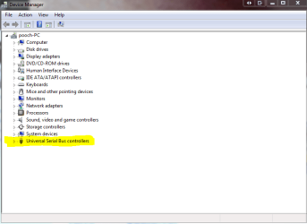

I bought a USB 2 port express card, 54mm, so I could have USB ports, but im having trouble with this aswell, first of all the express card came with a a USB lead, which im guessing supplies the express card with power as on the other end of the cable is a jack similar to that of a Nokia charger, I have tried using my USB wall charger to give the express card power through the cable, but this did not work, (had to this as USB ports are not working). Secondly, when I insert the card, i hear the "DING DONG", and then nothing else happens, it shows up in device manager under the USB section, which I find strange, as it is plugged in via the express slot, not USB, so surely it should be in the "PCI card" section of the device manager!!
The card is a USB device so it will show up in device manager under USB

Look in Device Manager
does it look like the marked part of the attachment?
Yes, my device manager does look like that, and when I expand the USB section, all looks normal, no yellow or grey tags, just the list of the ATI controllers for each port, and then each port is listed again,
