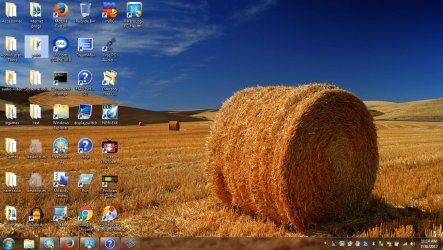

I ran through the "Calibrate Color" step by step and the extended screen is still green. See the 2 attached screen capture pictures. The top picture is my laptop screen, the bottom picture is the extended screen. The extended screen is pretty much usable as is except for some doc's that have color highlighted word back grounds.

See the attached pictures above. on the extended screen the sky in the picture was blue. But the bails of hay are supposed to be a tanish color not the color green that is the lawn in front of my apt.

I finely solved both the lack of color period in the extended screen and got the hue correct now :D :party:. I had to get into AMC Catalyst control center. There is a pull down menu to control the HD flat screen tv in PC mode. The color gain slider control for the flat screen tv in pc mode was some how set to 0. I slid the slider up to a little over 1/4% and the color is back and I changed the hue slider a bit so the hay field is now the tan color that shows on the laptop screen
