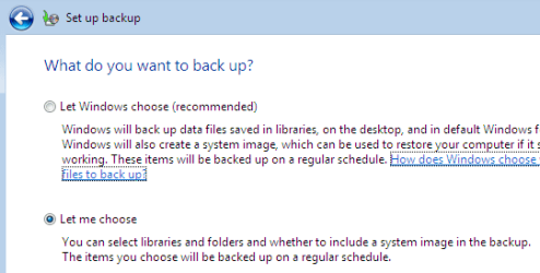

Yes, the ability to create and restore (you can restore an image saved to a partition on a hard drive with either the install DVD or the Repair CD) a hard drive image is built into 7: Just type 'backup' in the search box to find it -->

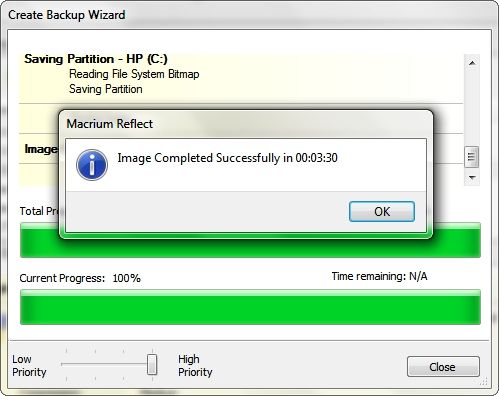

I use a LaCie 2 TB Raid 0 eSATA drive that I back up to using both Windows 7 System Imaging and Macrium Reflect. It backs up a 7.5 GB Macrium Reflect complete Image in 3.5 minutes...
And restores the Image from the Raid 0 drive in 4 minutes and 40 seconds which makes for a very quick recovery form any disaster and a 25 GB Windows 7 System Image only takes about 5 minutes and 45 seconds to restore when using this eSATA Raid 0 drive...

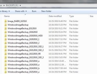

Win 7-64 Pro here. I am also running RAID-0 and I image with Win 7 backup daily since I turned off my system restore.
How I restore my image is almost the same way Stormy did. Except after step #3, I don't restart or I'll lose the "loaded RAID driver". Then install my USB 3.0 driver (my backups are on external USB 3.0 docking.
After RAID driver loaded I use diskpart to clean and create partition and assigned drive letter. Then just restore the image from my ext USB docking HDD.
So basically I am done at step #3.
I wasn't kidding I image my everyday maybe more then one if I did something dump I can go back in no time :D just keeps rename the windowsimage directories :D
